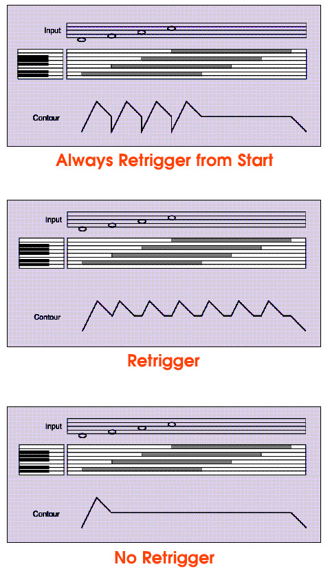

I would like to ask for a feature request that's been hindering a lot of things I'm trying to do on the Pro3:
On for example the Sub37, you can set an envelope to always retrigger from the start, whenever you press a note. This is very handy for when example you try to play a slow, soft melody with a long attack time.
As it is now the envelopes react like with voice stealing, causing a sharp attack spike for every legato played note. Very annoying, I have to adapt my playing style and use reverb and delay to compensate for the untied notes.
You could put it as an extra option in the misc params: on (which is the current) off (no retrig), and all (always)
This would really benefit the range of this synth, and it seems like a quite easy fix!

There's a difference between retriggering and resetting the envelope. The Pro 3 retriggers it, as do most vintage synths. What W07 is asking for is actually resetting.
Resetting the envelope nulls out the current envelope state and starts the envelope from the null whereas retriggering starts the envelope relative to where the envelope currently is. For example if you have a long attack and reset the envelope it will close the envelope and start the long attack again. If you have the same long attack and retrigger the envelope the attack amount is added to the current state and you won't hear the envelope restart. Both are useful so having the options is helpful.
