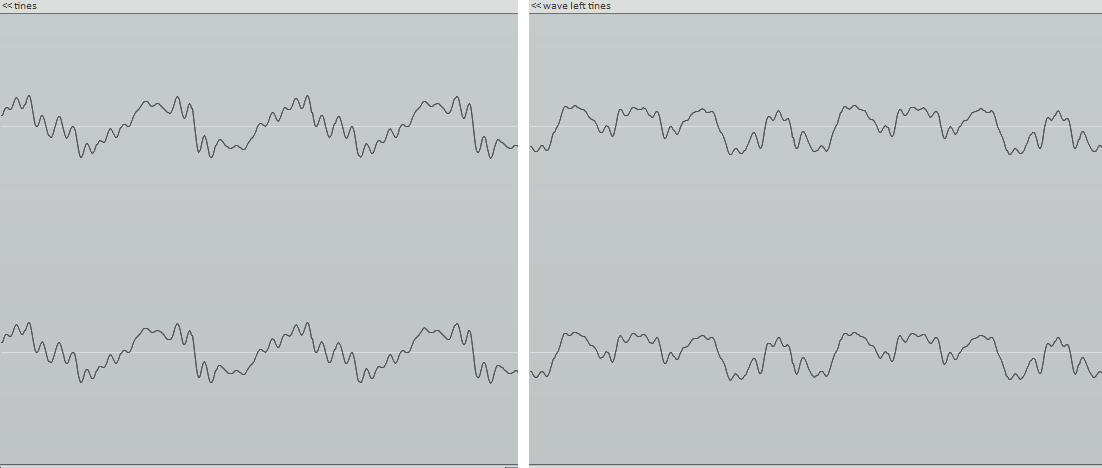

Also I attach screenshots from my DAW to compare the two different waveshapes.
Left side of pic: "Tines"
Right side of pic: "Tines" assigned to "WAVE LEFT",  Shape Mod = -64"
http://www.interruptor.ch/PRO-2_wavetables_-_Tines.png
