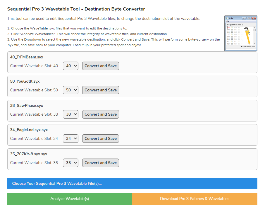

Here's another Pro 3 Wavetable Destination Edit Tool:
Web based, with ability to convert multiple wavetables in a batch... for those without the Bash superpower or the shell shy... ;)
https://www.presetpatch.com/Pro3WaveTool
